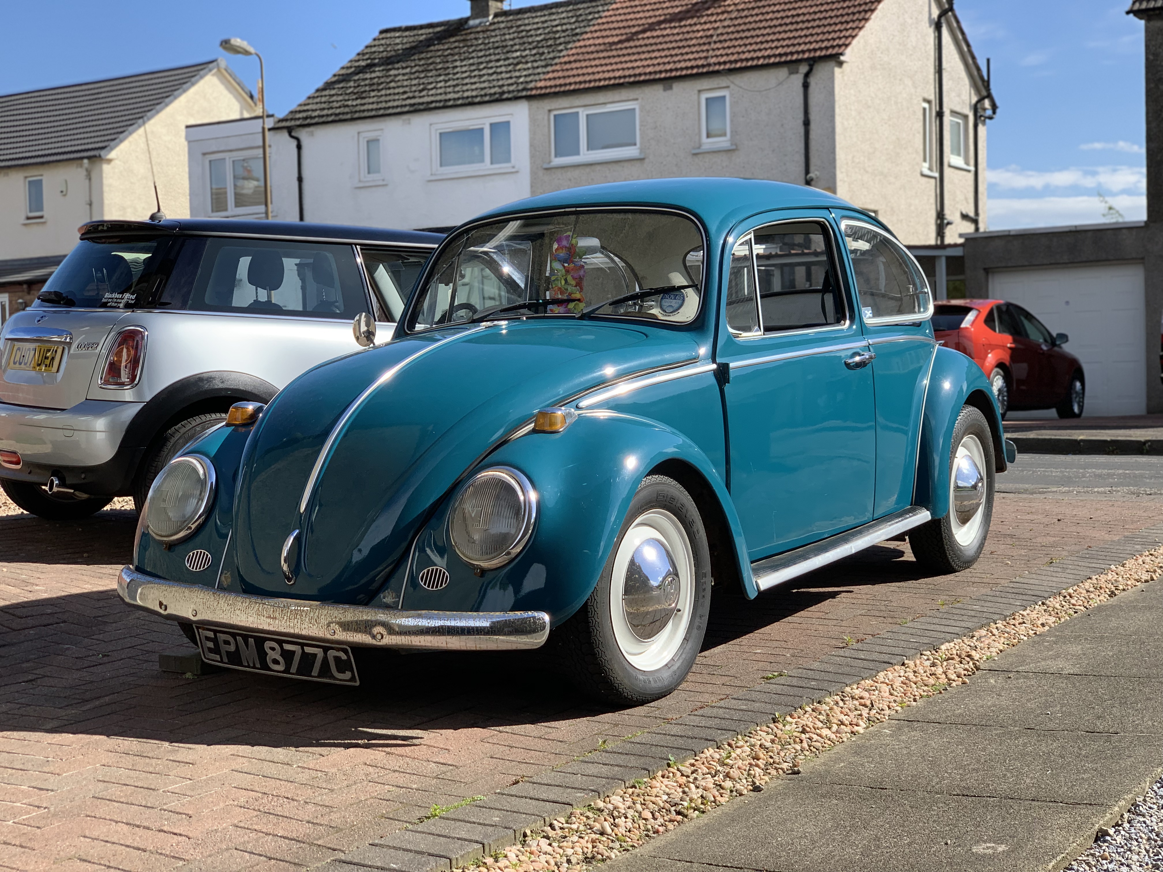

Hi all, this is my 1965 beetle I’ve owned for a couple of years and plan to get it on the road for summer 2020.
Jamie
Nice bug Jamie!
Nice looking bug there Jamie.
Roll on Summer 2020👍🏻
Nice bug Jamie :sunglasses:
Be good to see it out and about this year Jamie. Great colour.
Very nice bug, have fun and be safe
