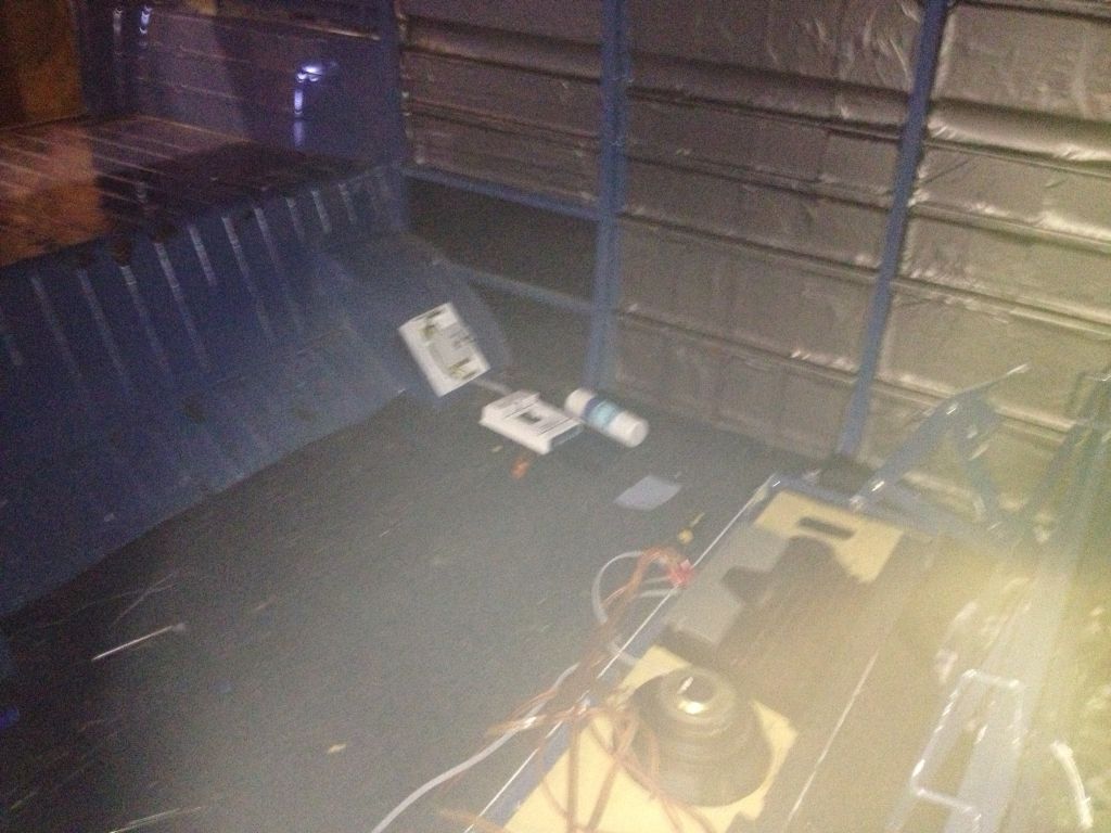

Started fitting the flash tape insulation today with the help of Russell and Colin… Cheers guys! Makes a massive difference going with the ‘tap test’ which hopefully equates to a nice quiet ride. It does take quite a while to do but I recon the final result will be worth it.

Got the rear stripped out tonight ready for more flash tape. I’ve tried both types; Screw Fix own make and the 3M stuff, for me the 3M stuff is better, it seems to be a bit heavier. It takes AGES!! a heat gun is also essential.
The previous owner glued carpet underlay to the cargo floor, it’s going to be a bit of a mare to clean off…
Not my favourite job but I’m getting there…
