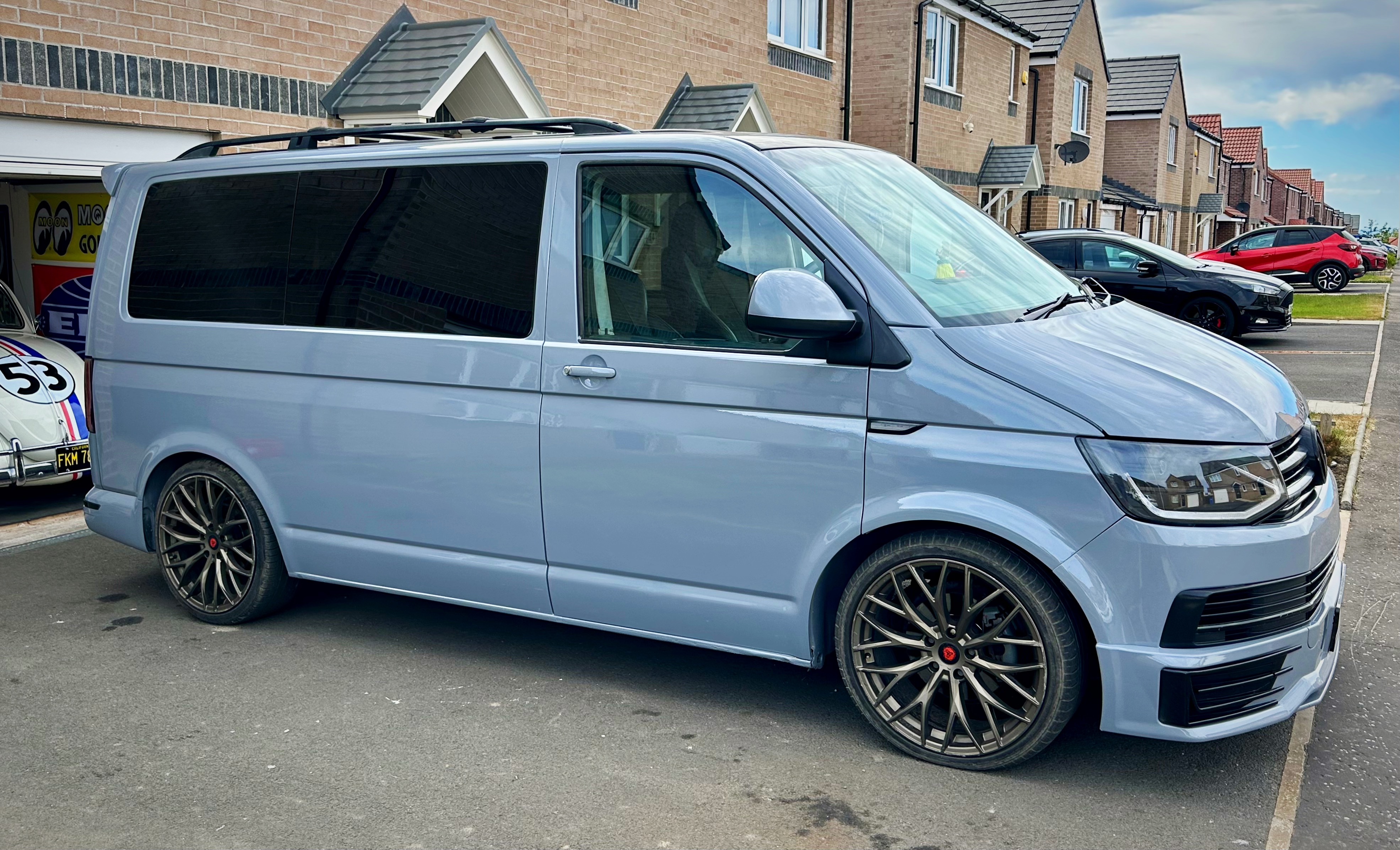

Hi all, the Mrs and myself have recently bought ourselves a camper! We’ve fancied one for a while for- funnily enough, camping! But also so we can do some big roadtrips, and tow Herbie to some of the big VW shows down south. Last week we picked up this T5 which has had a T6 front end, and rear door fitted to modernise it a little. We have a TONNE planned for it so will keep the thread here updated! :blush:

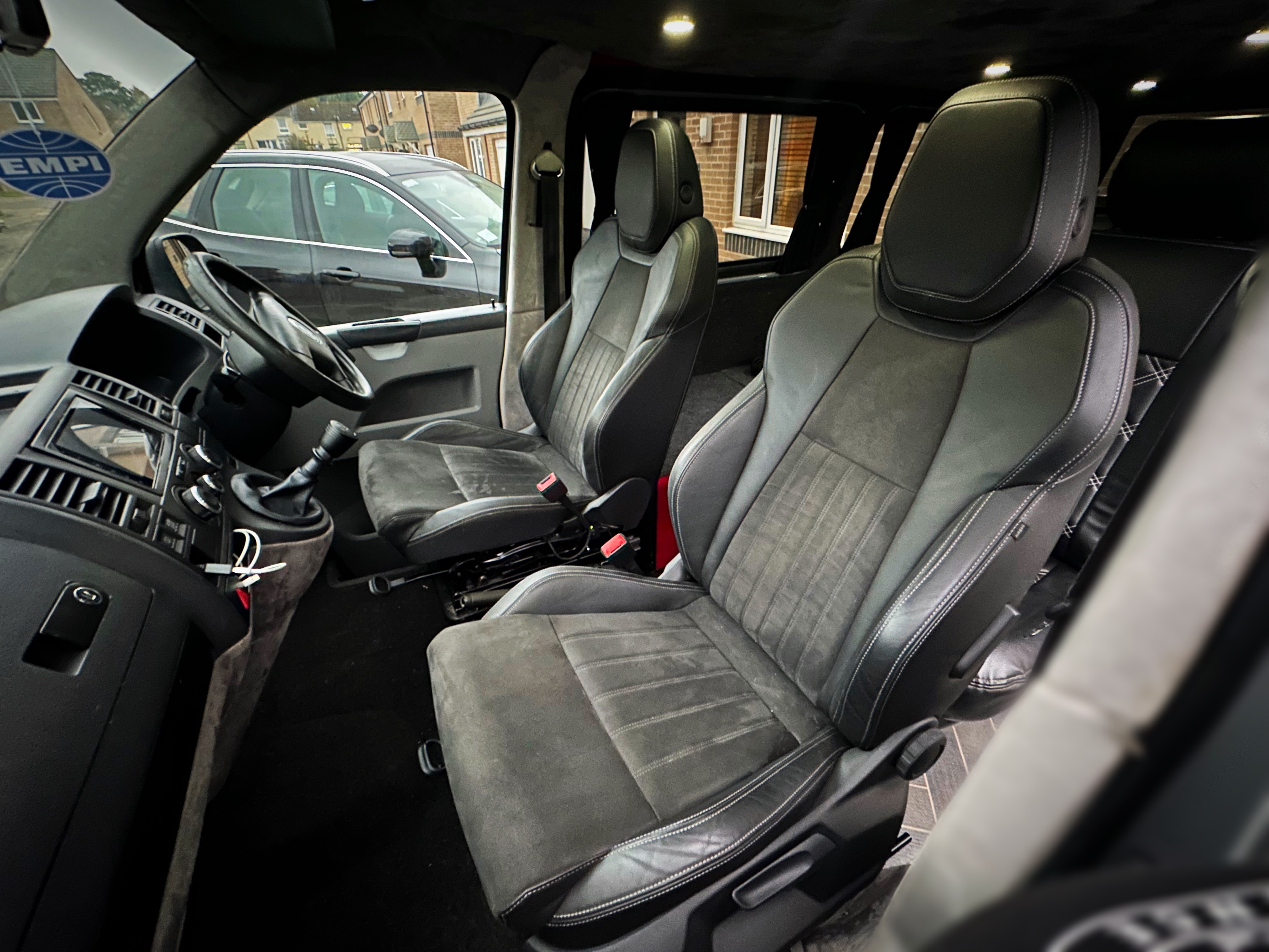

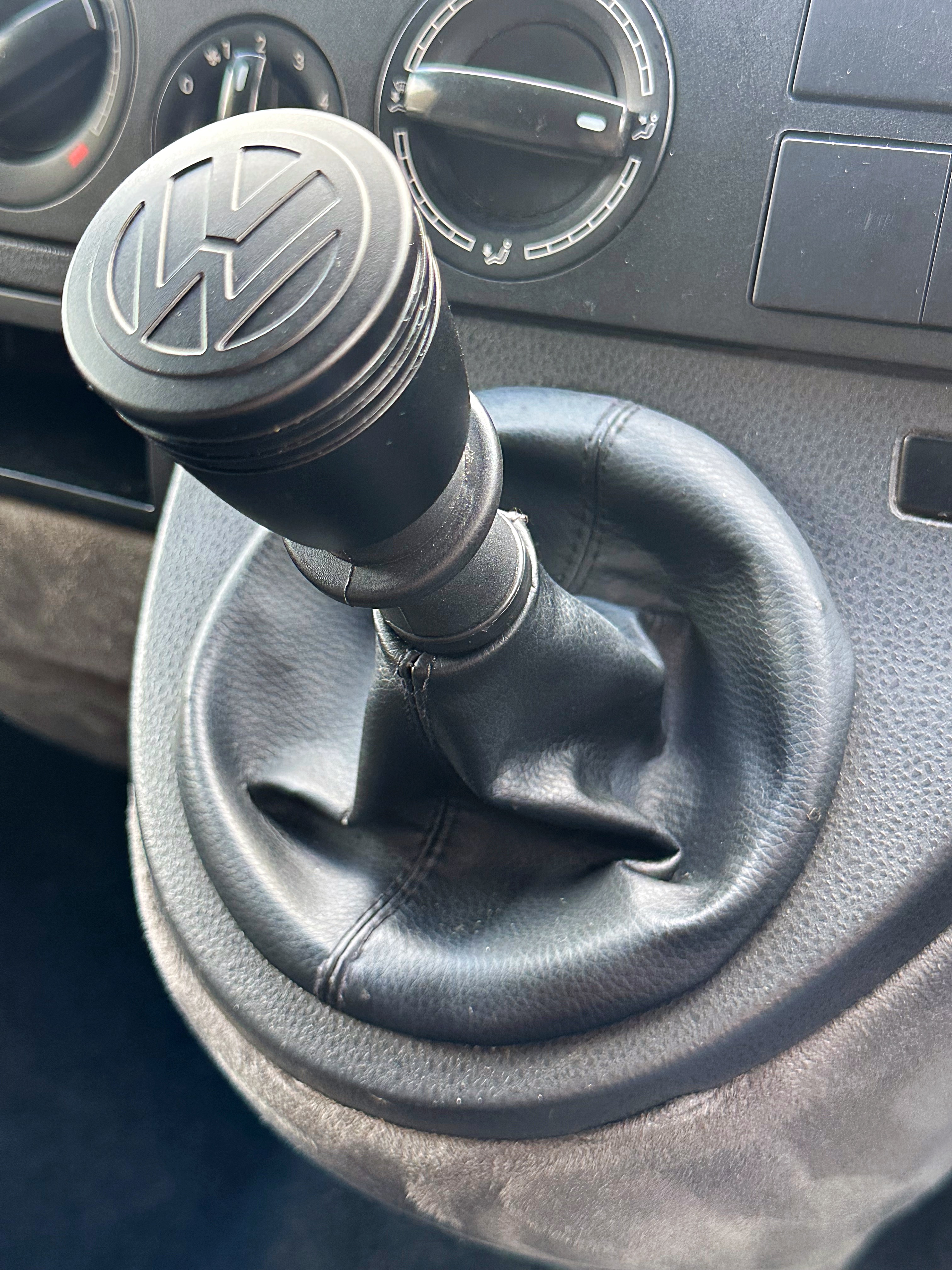

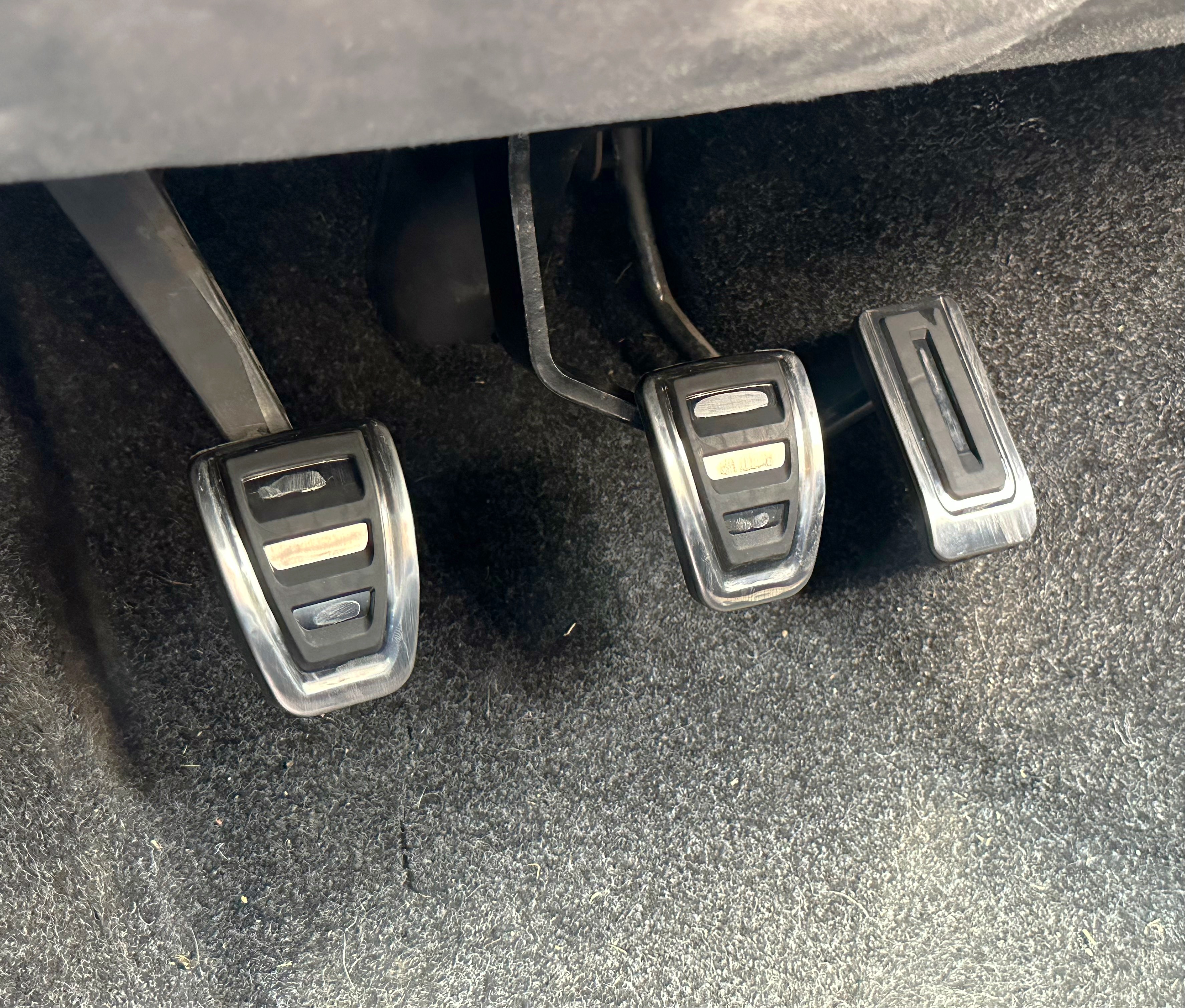

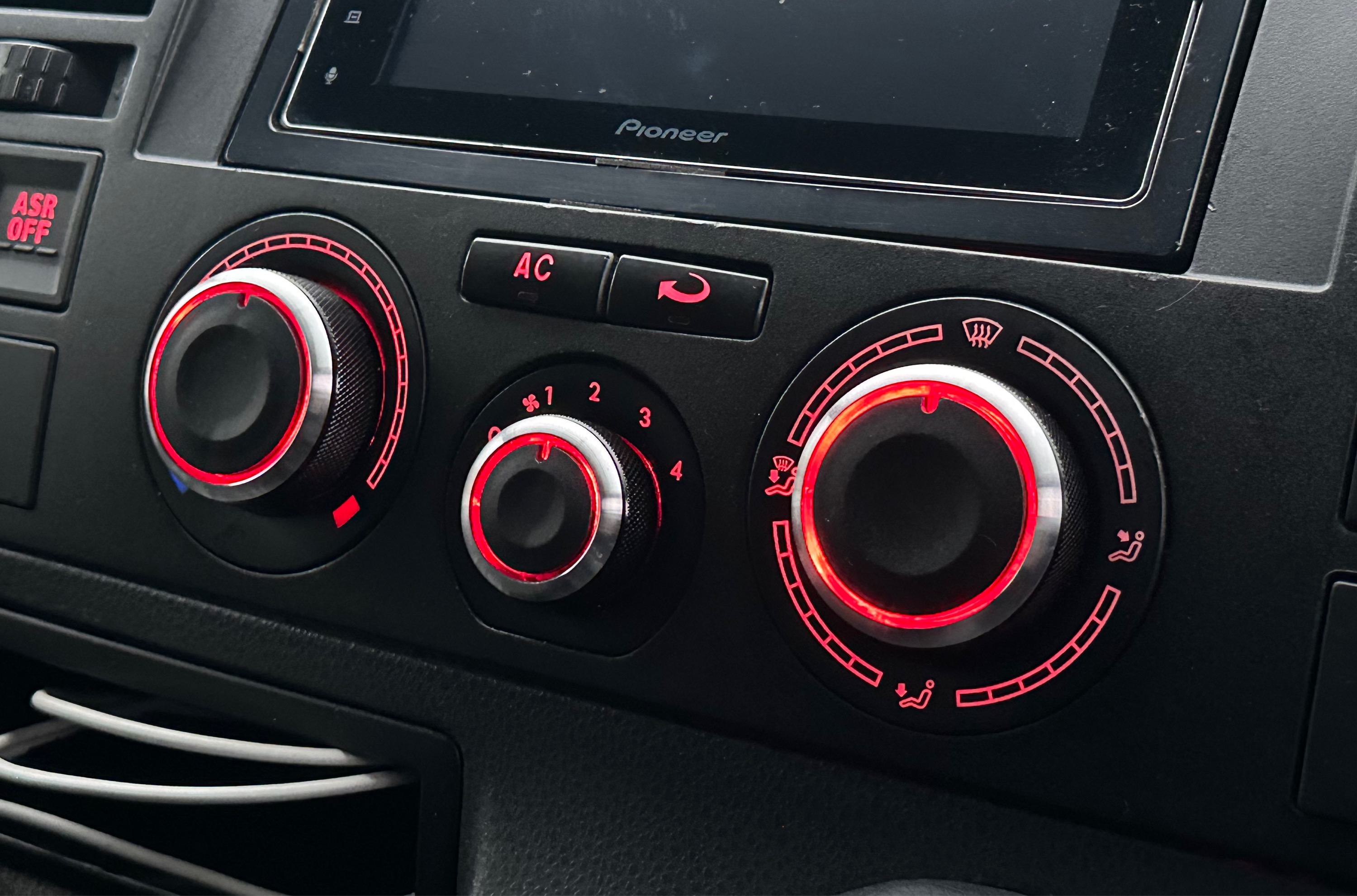

Started to make some upgrades this week! Realistically, the exterior needs fresh paint and we plan to do that over winter, so I feel there’s no point buying any outside goodies until the paint is done. But we have made a start on the interior! This past week we’ve added some nice pedal covers as the original rubber ones were almost worn right through! A new billet gear knob, more modern looking heater control knobs, and finally new seats! We wanted to get rid of the double seat which we didn’t like. Lastly a new steering wheel is en route so will post an update once that’s in too.

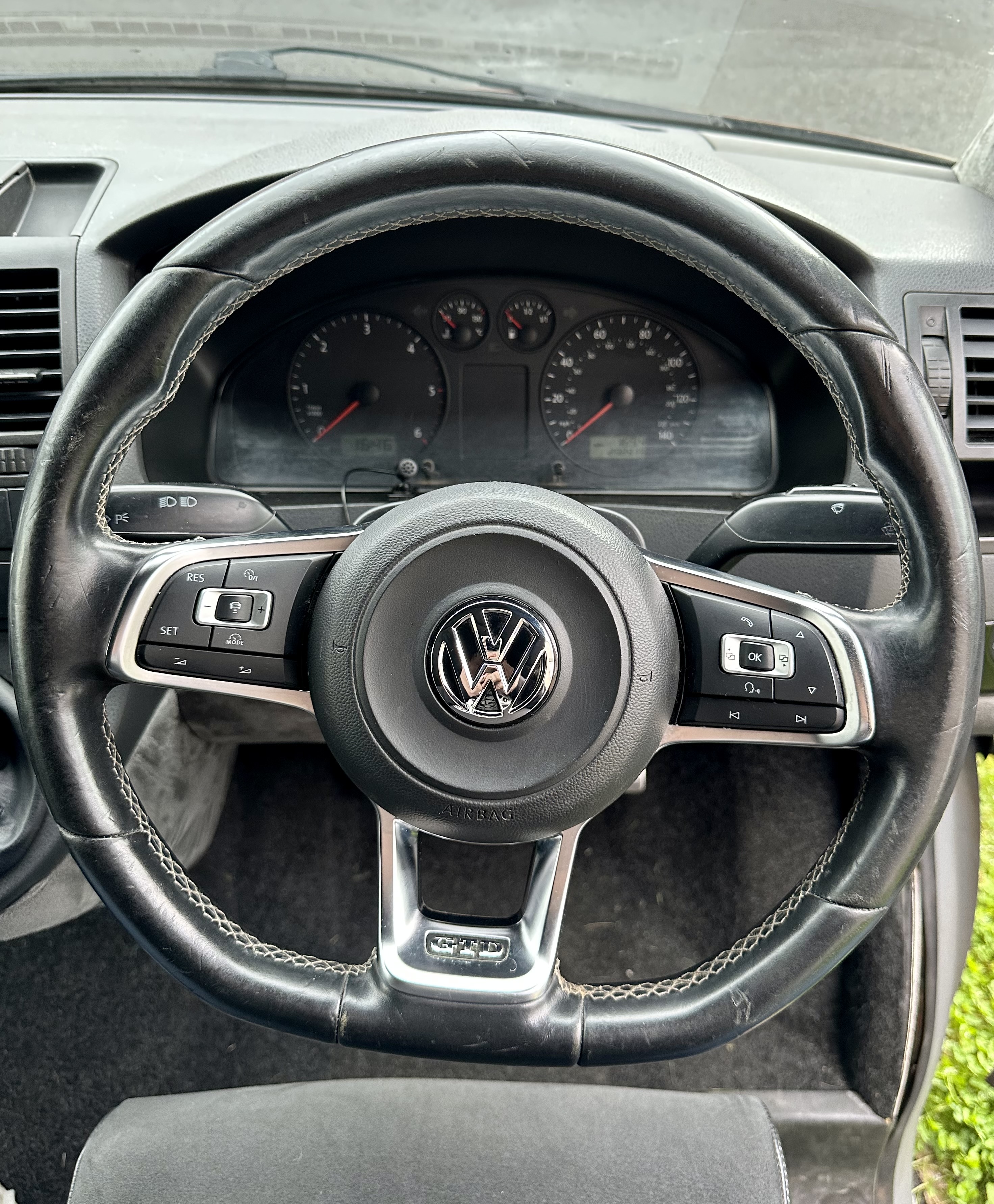

New steering wheel fitted today, an easy enough job with a T5 to Mk7 Golf adapter airbag loom from ‘Patrick Steering Wheels.’ Was a case of just plug and play. Makes a massive difference to the look of the van!
Looking good, those seats looks cracking ! what are they from ??
Thanks mate, believe it or not- a Skoda Karoq Sportline! Was pleased to find them! We were originally looking at Mk7 Golf GTI/GTD seats, but glad we went for these instead.

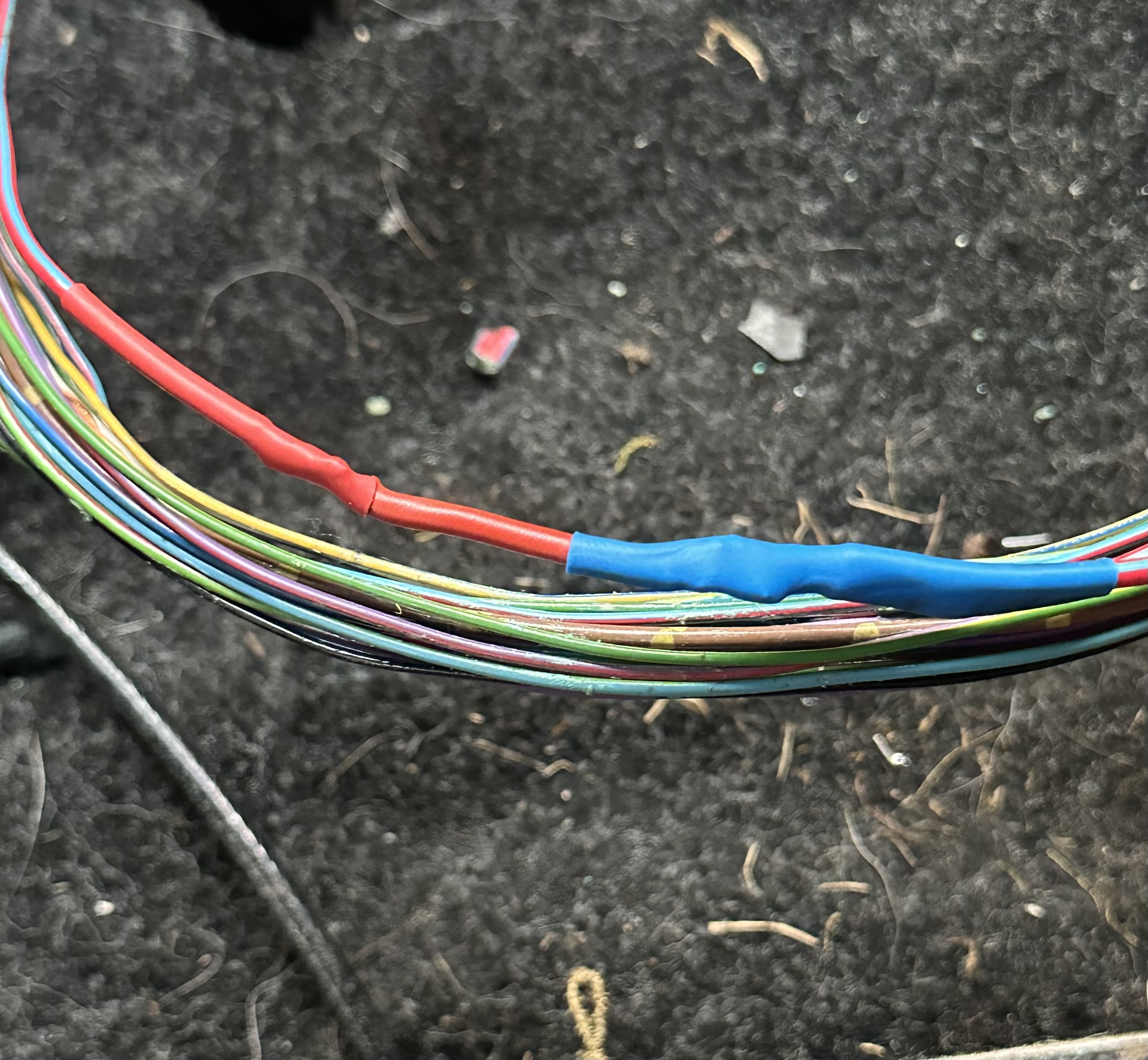

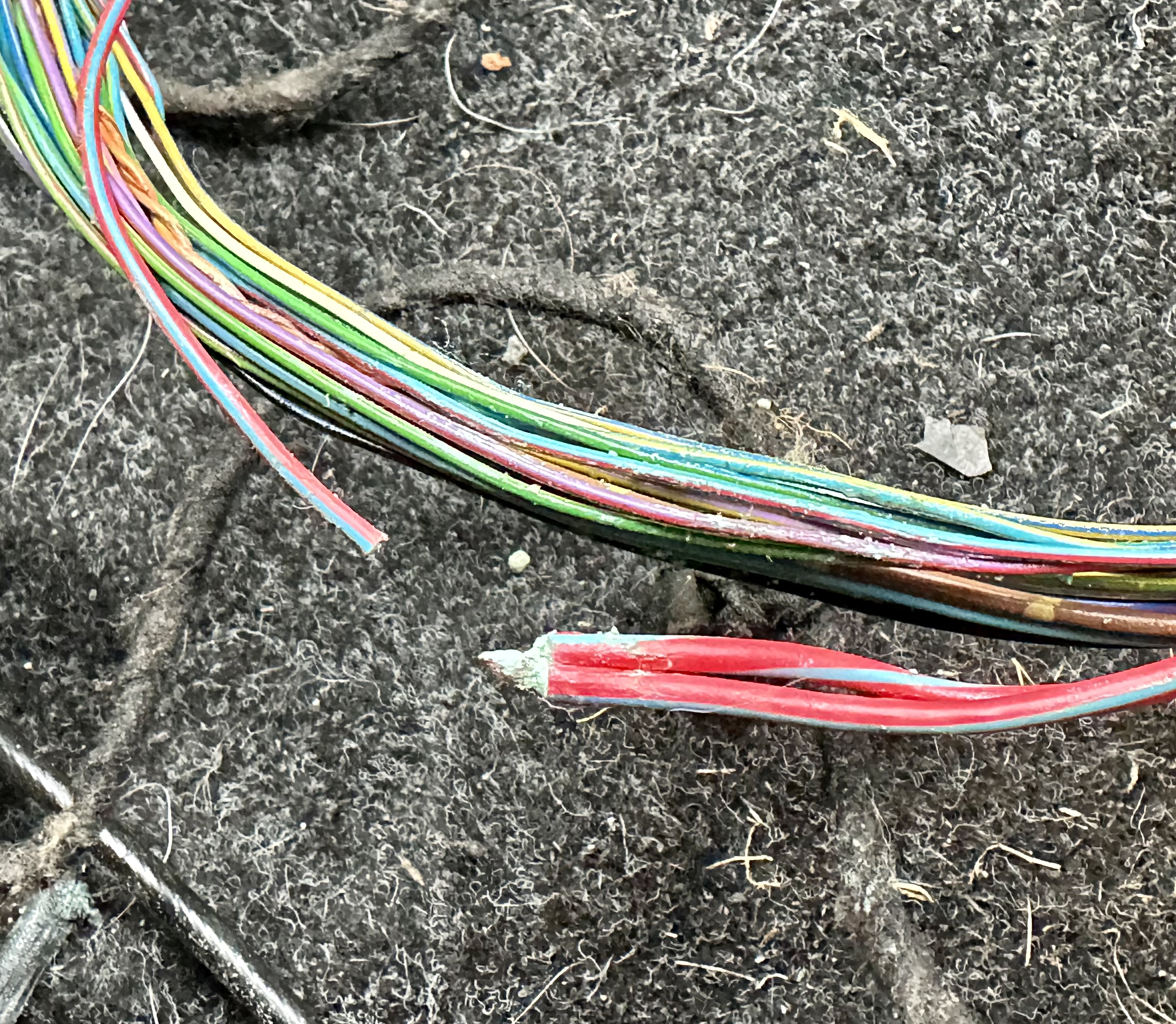

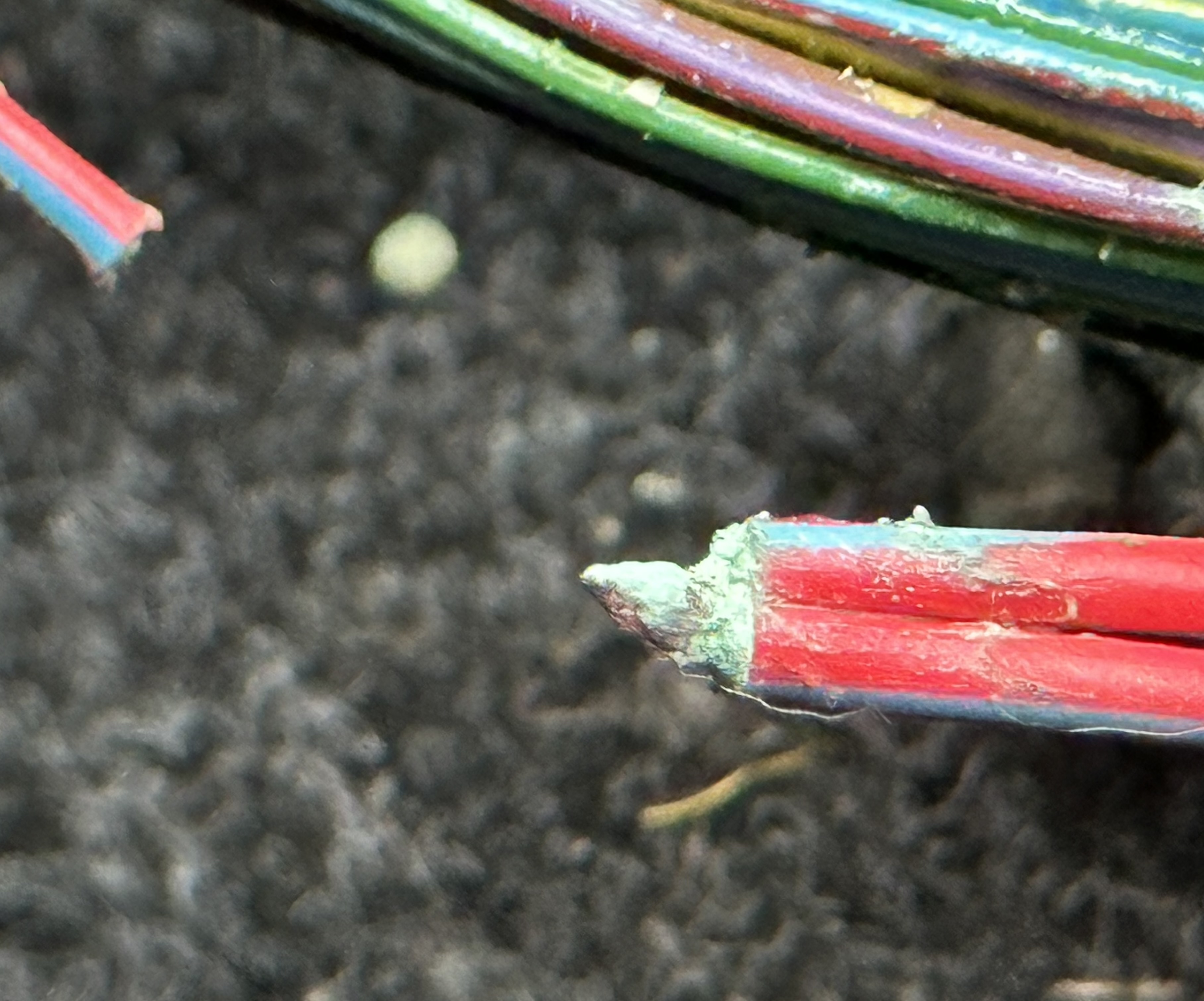

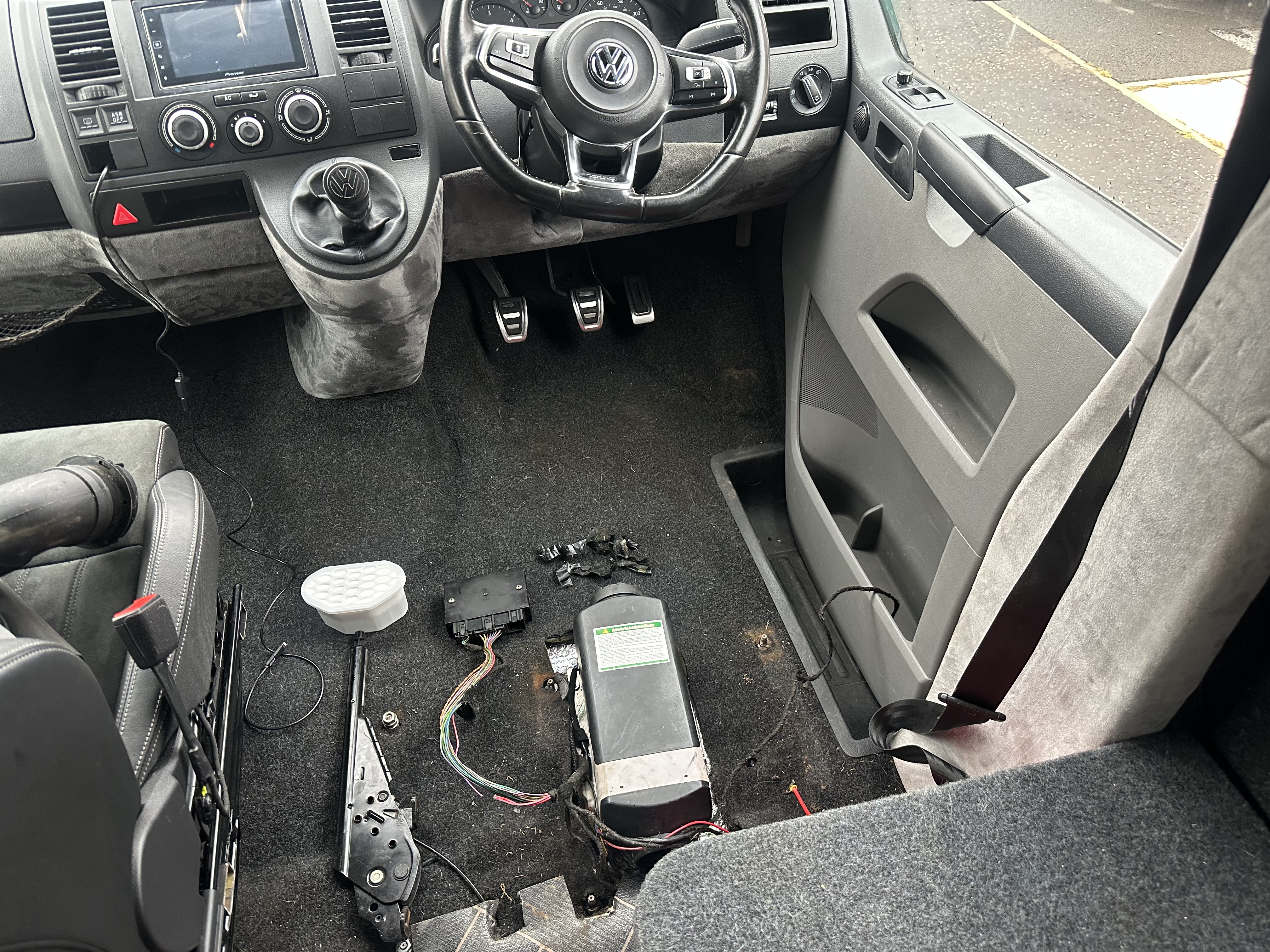

Wee update on the van. So over winter we’ve put together a wee list of the things needing sorted on the camper project. Today I tackled the first one, the central locking- which via both remote and manually had stopped working. After doing some research I found that it’s common for the factory solder on a wire under the drivers seat to fail due to years of condensation. Today I pulled the seat and investigated… Right enough, the connection was totally green and literally crumbled as I unwrapped it. Cleaned it all up, cut the bad pieces of wire out, re-soldered and we’re back to having a properly locking van! First thing checked off the list!

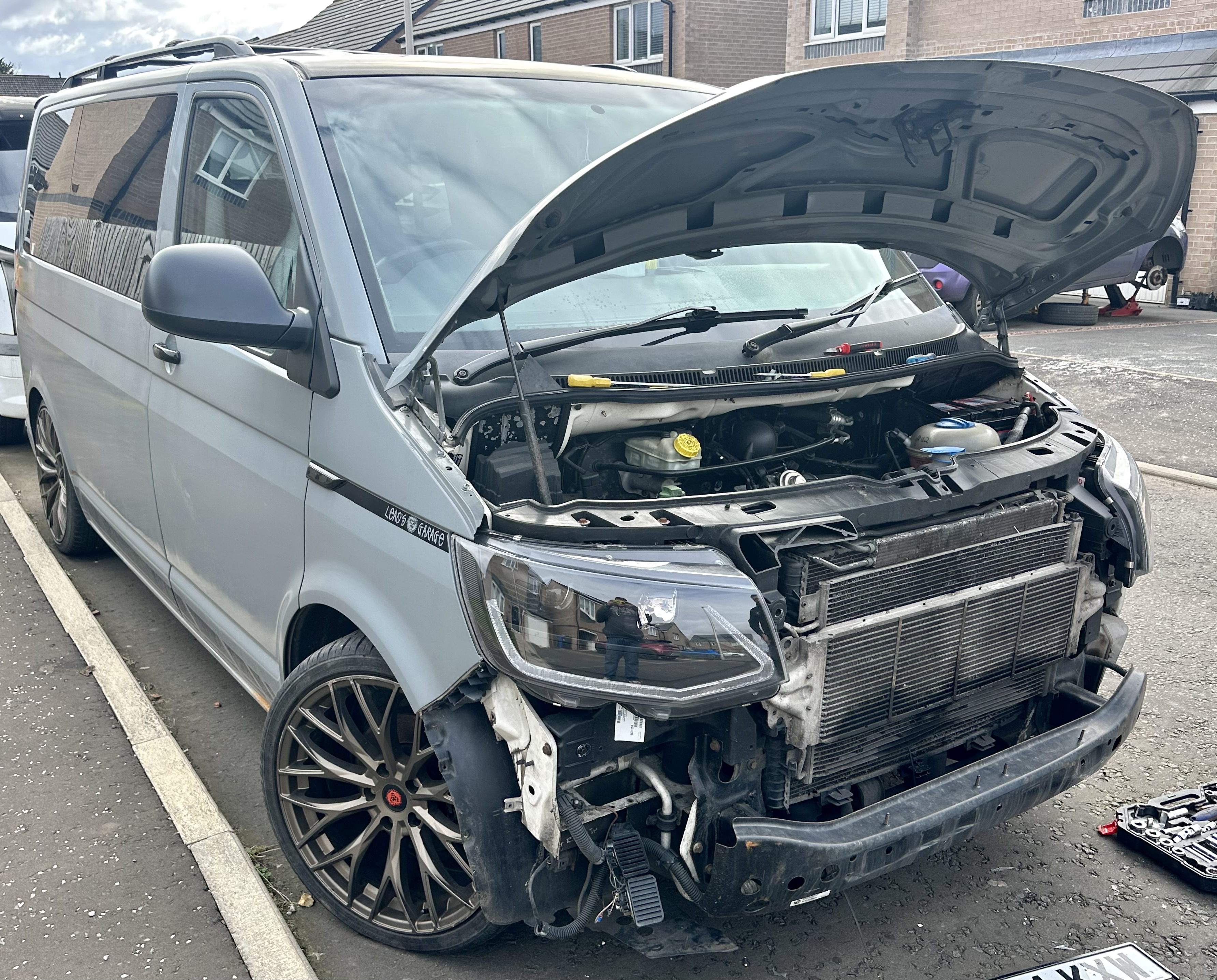

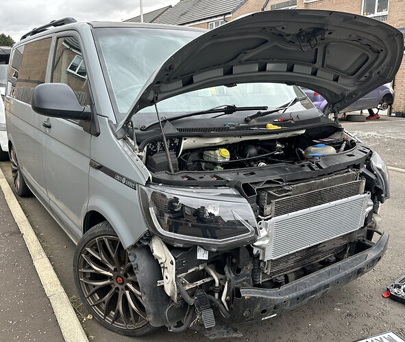

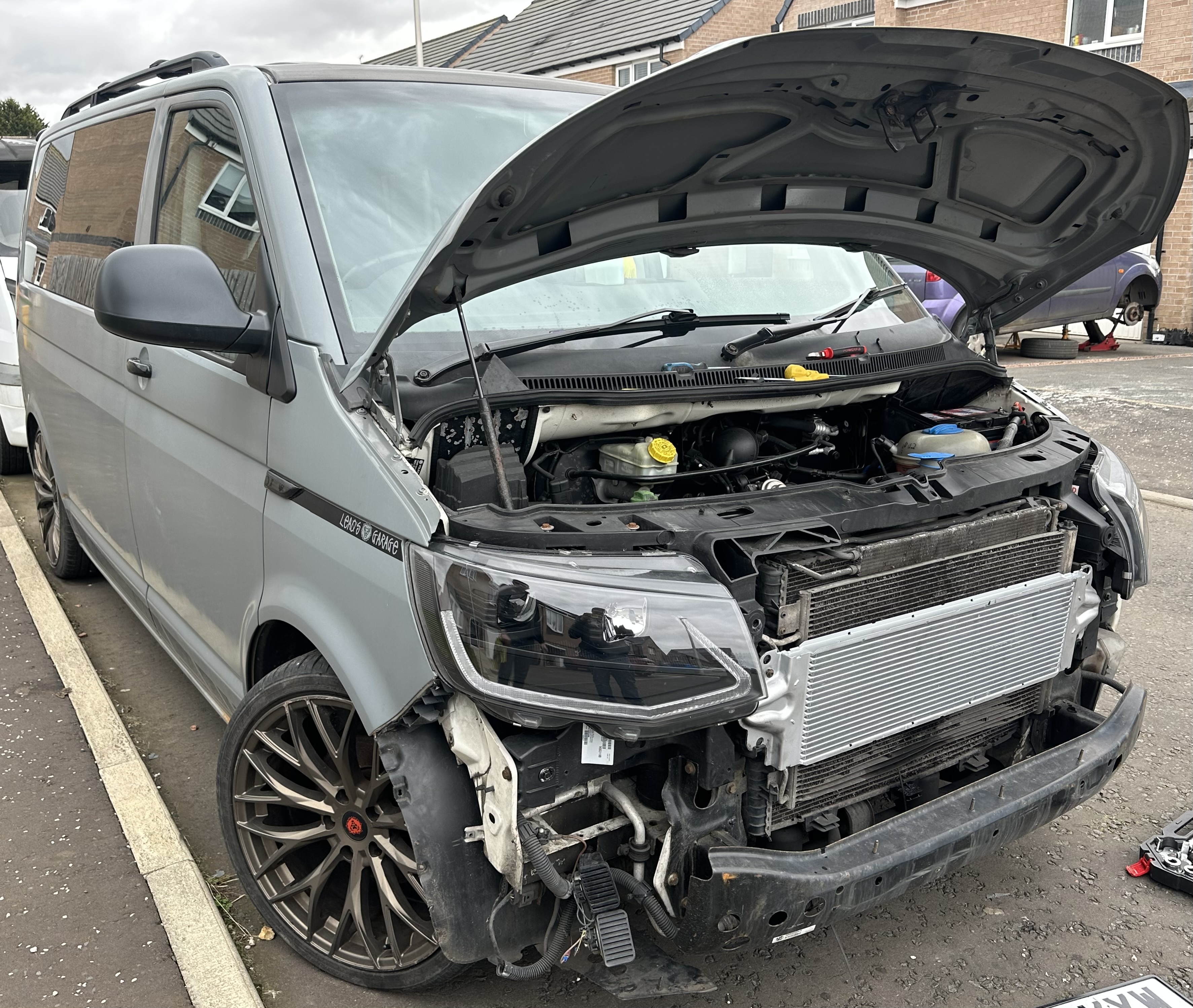

New Inter-coolings today!! Huge difference, the van pulls properly now that it’s boosting properly! :rofl:
That’s looking good! Every turbo motor I’ve ever had, I’ve spend loads of time looking for boost leaks :joy:

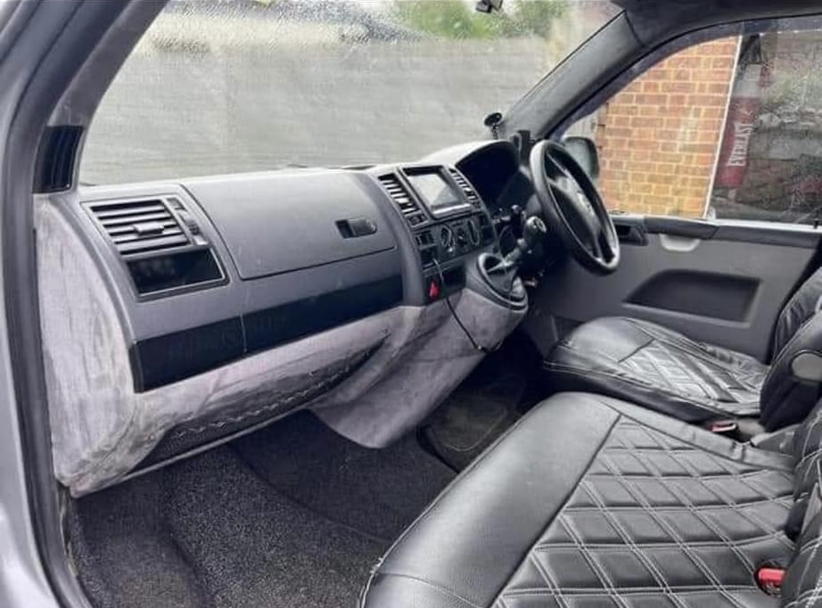

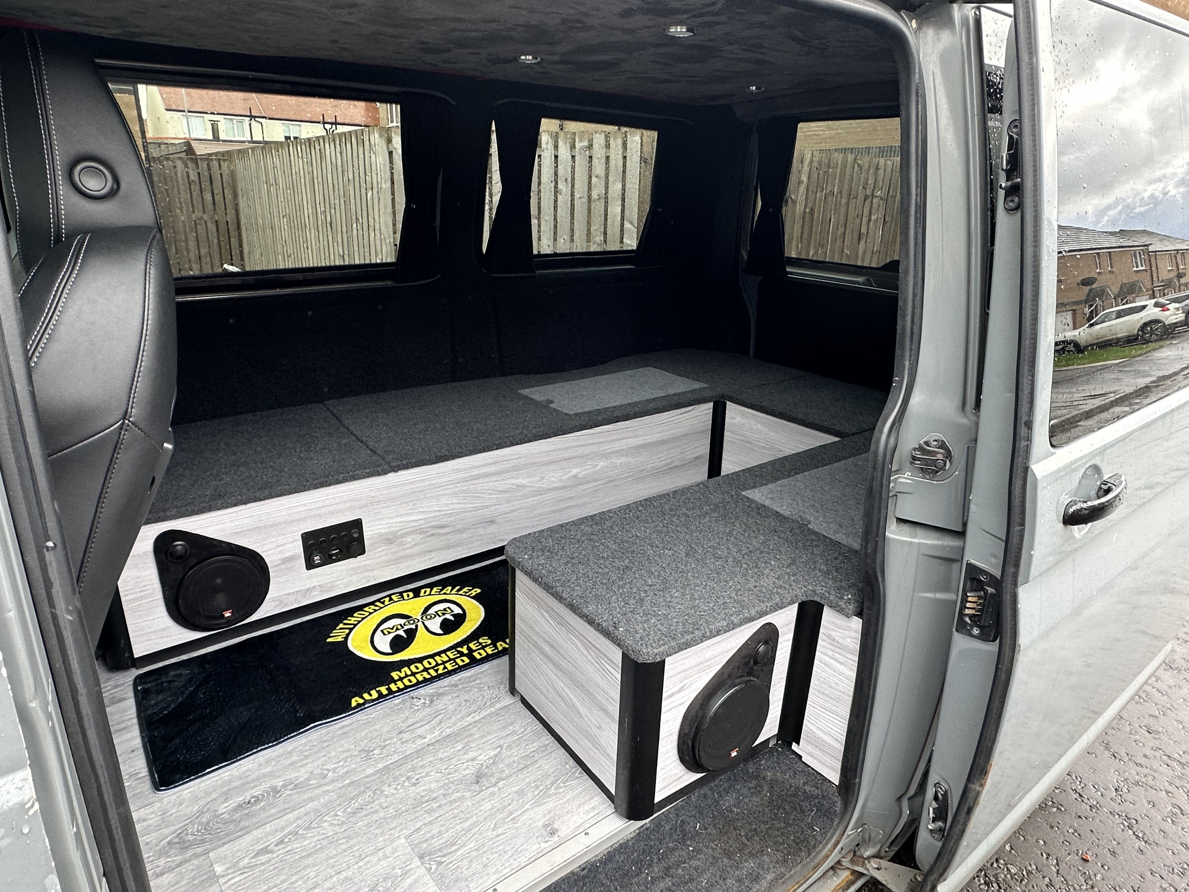

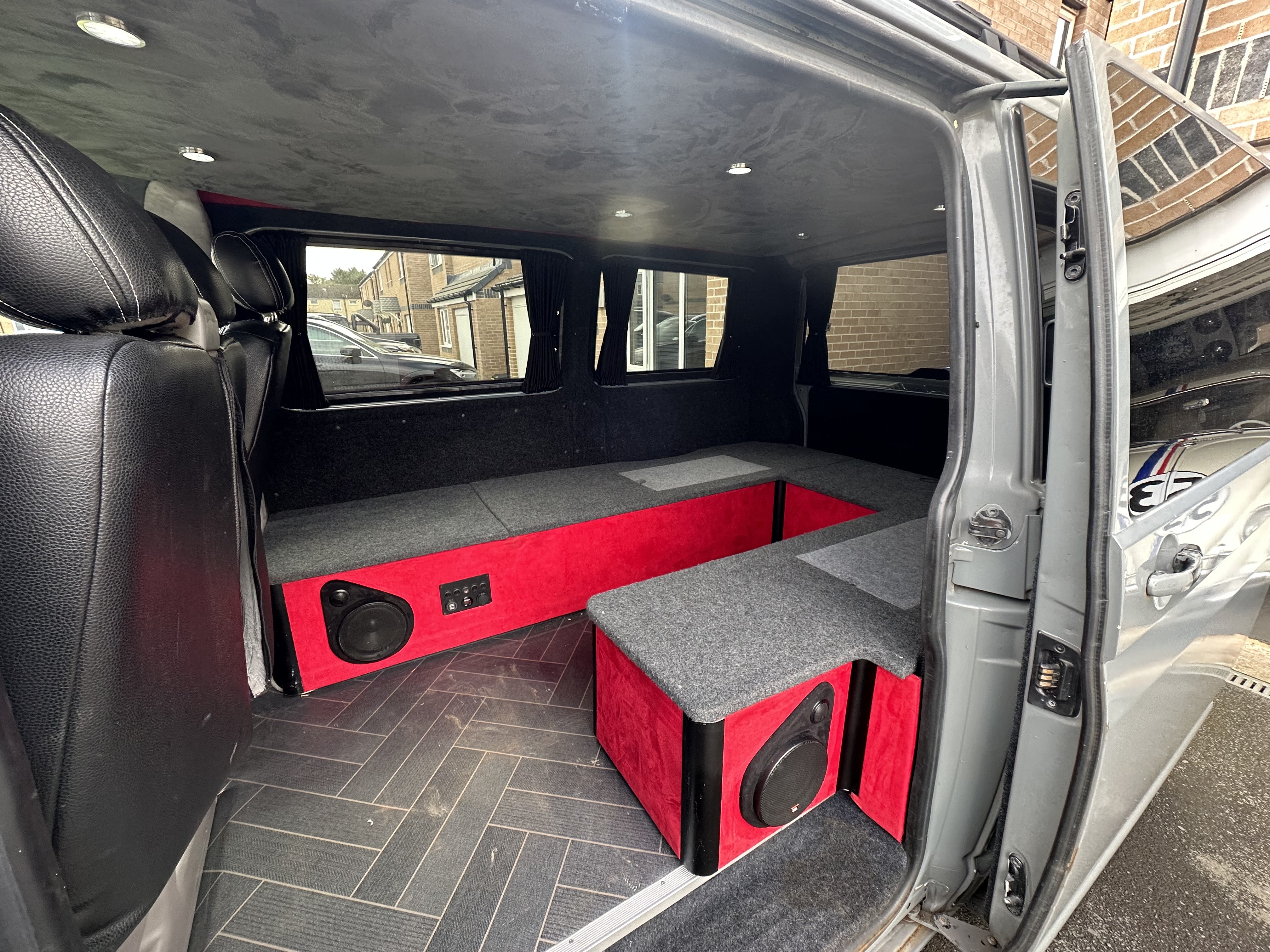

Gave the back of the van a little facelift this weekend. Looks so much nicer in our opinion, and more modern without that horrible red suede. We’ll still be adding bits and pieces to it- like a table for the U-shape I’m working on today. Before and after below.
Before
After

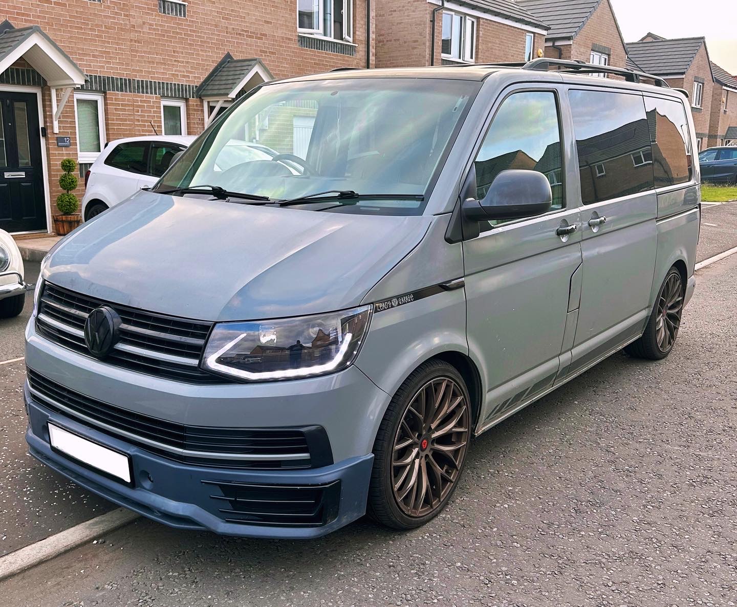

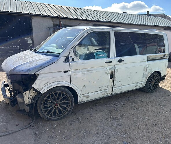

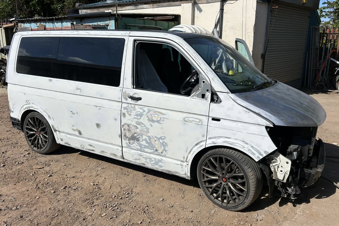

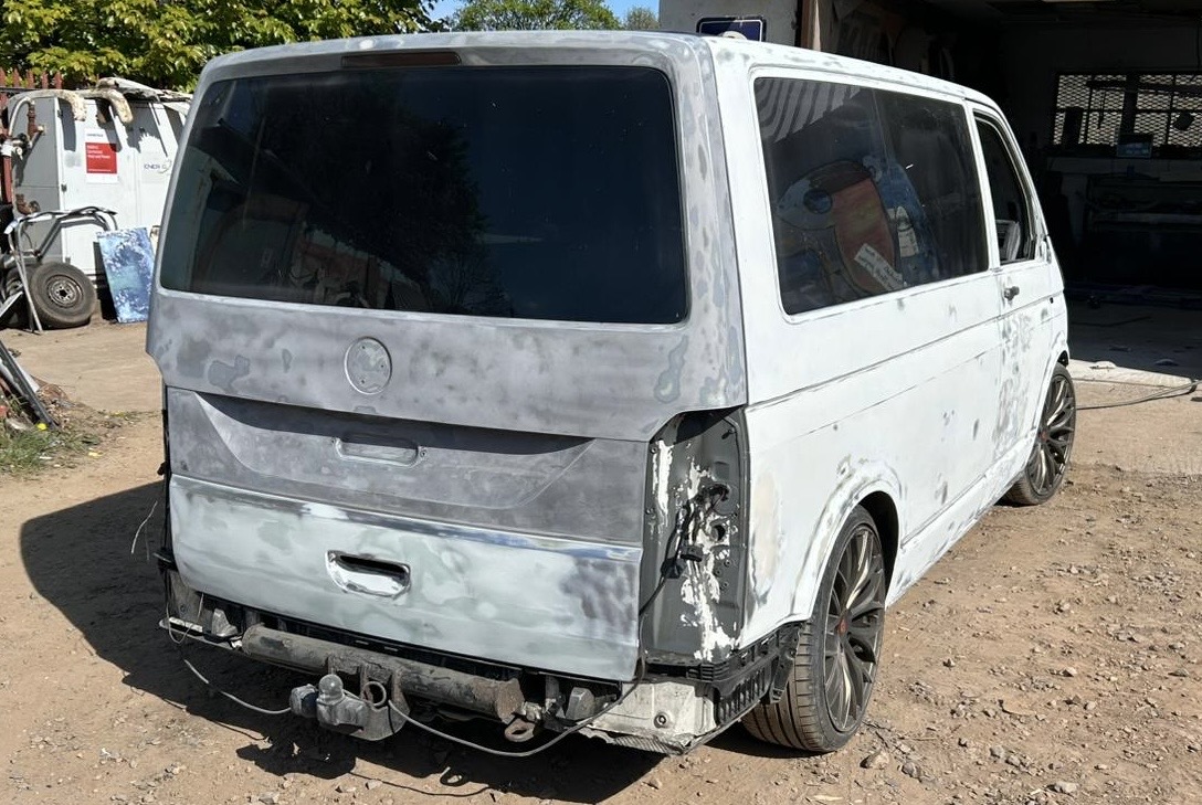

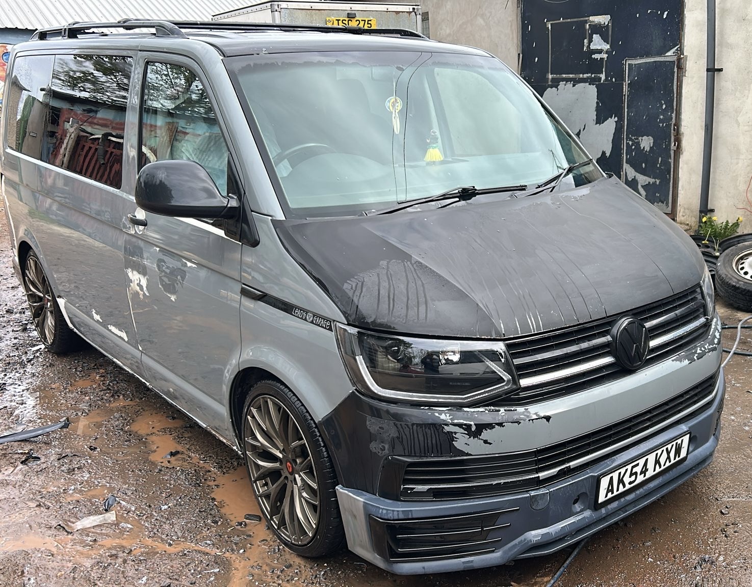

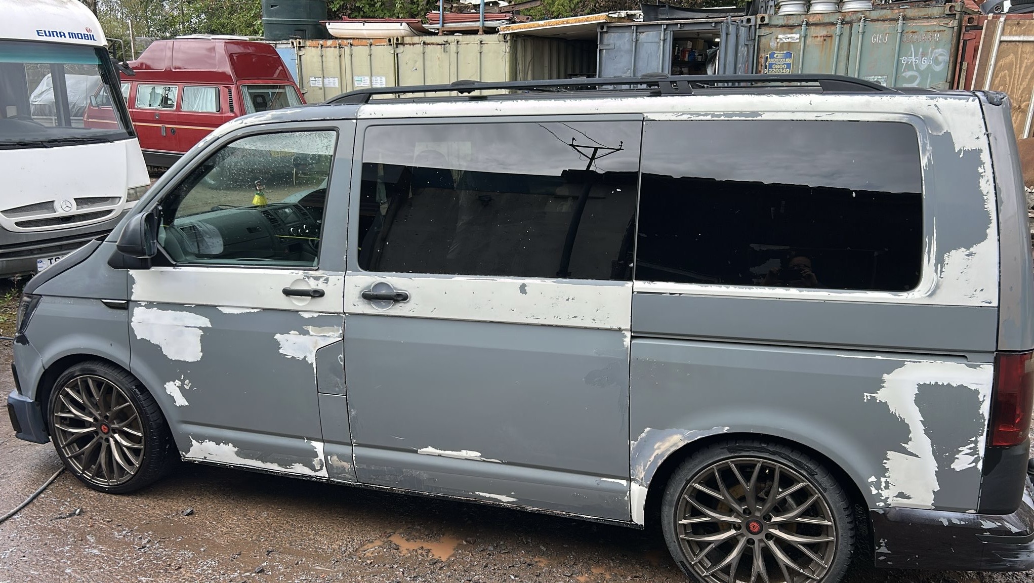

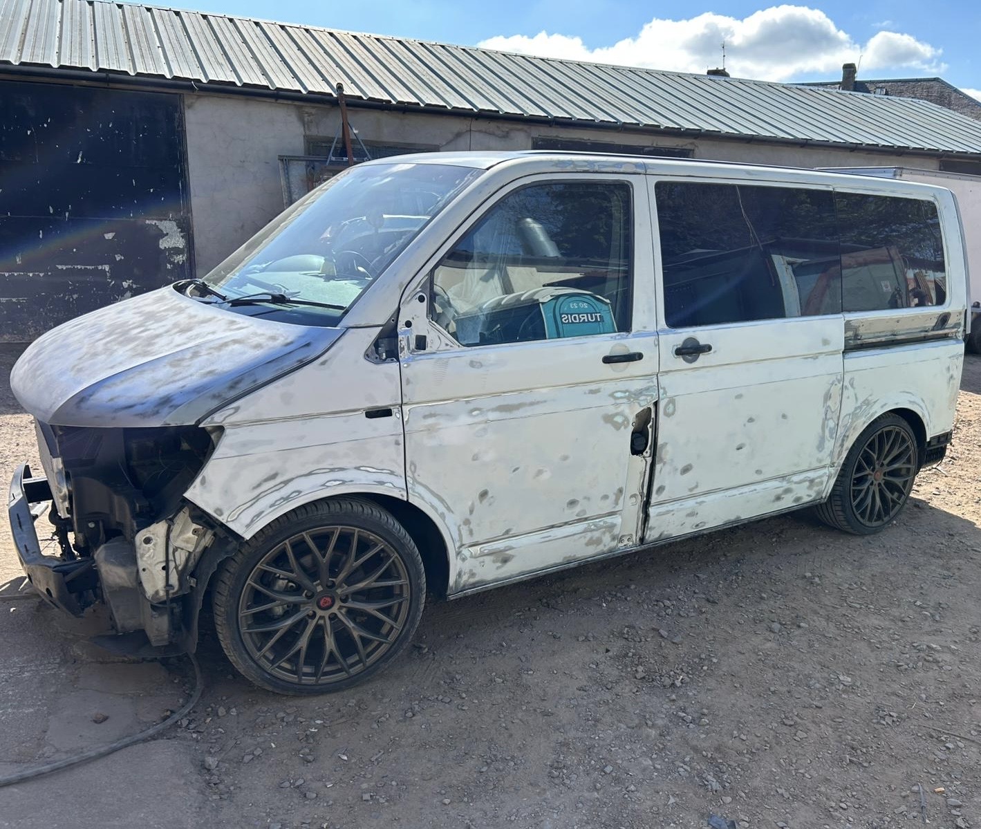

So, a couple of weeks ago- we bit the bullet and sent the van away for paint. Here are a couple of pics sent from the bodyshop. The first 2 were after the van had a high pressure steam power wash, and the next 3 were the van prepped for paint. Looking forward to getting it back, and I will update then!

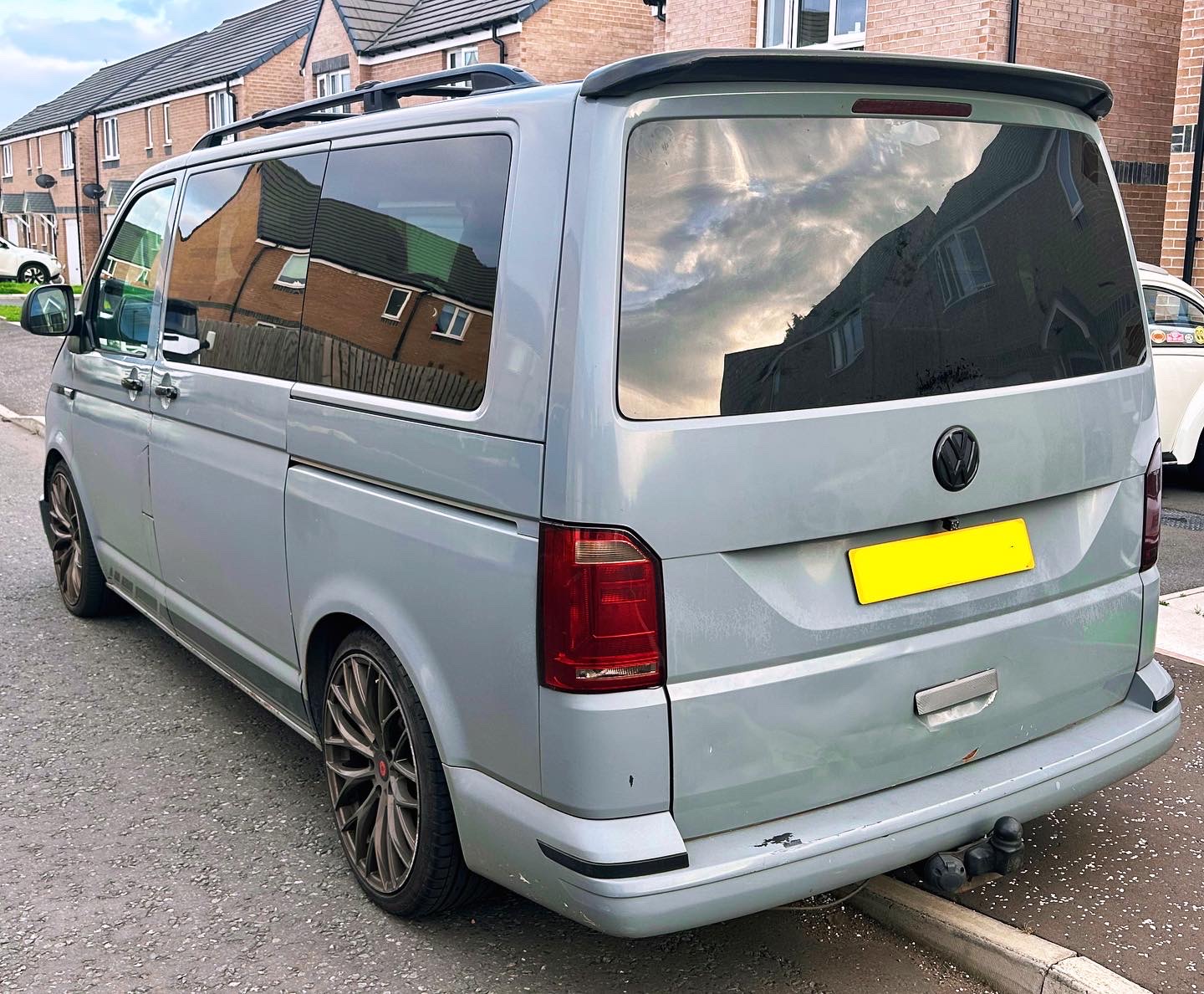

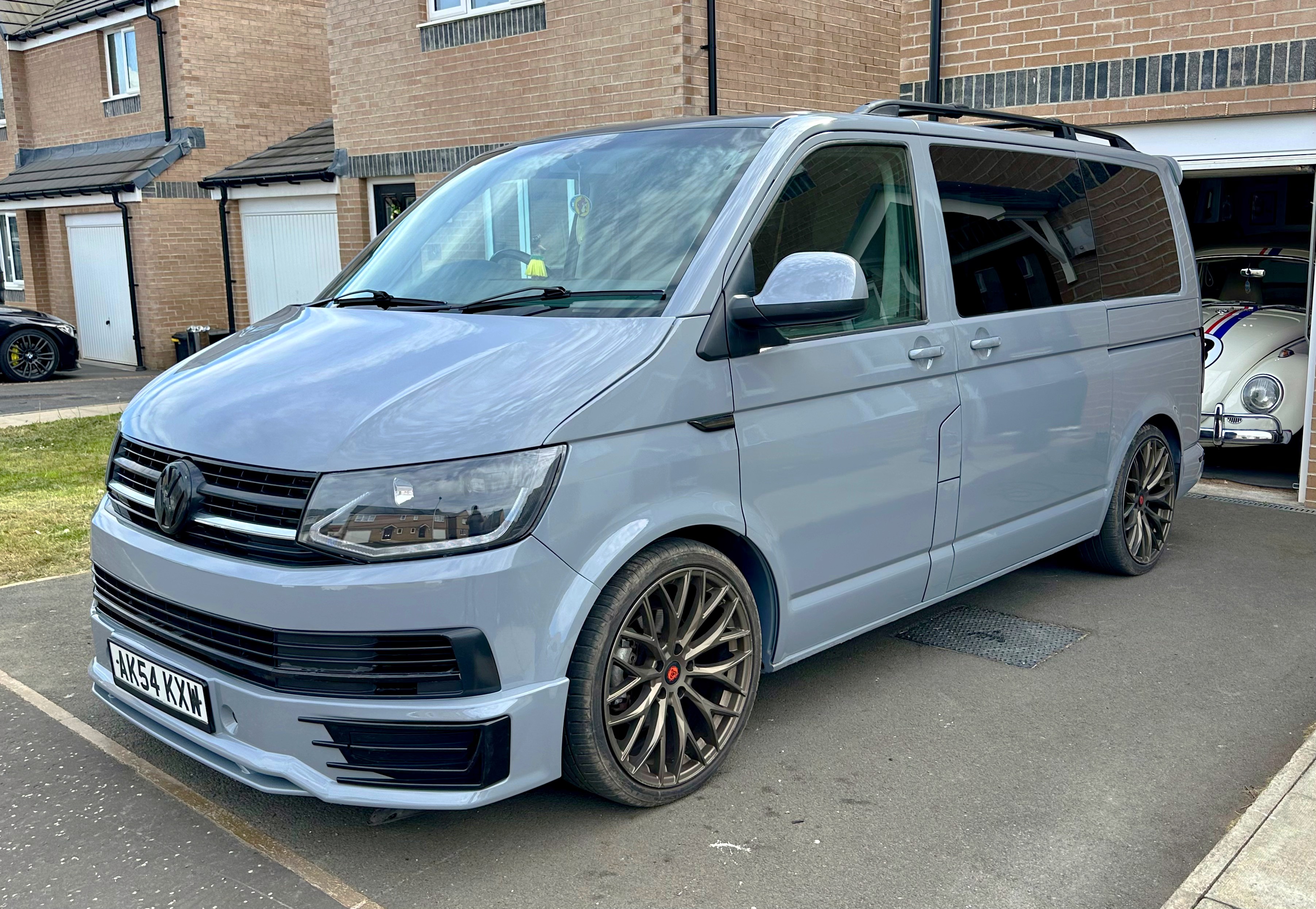

The van returned home today! Chuffed how it’s looking. Still a lot of work and mods coming, but it’s so nice to have a nice, shiny canvas to work with now!

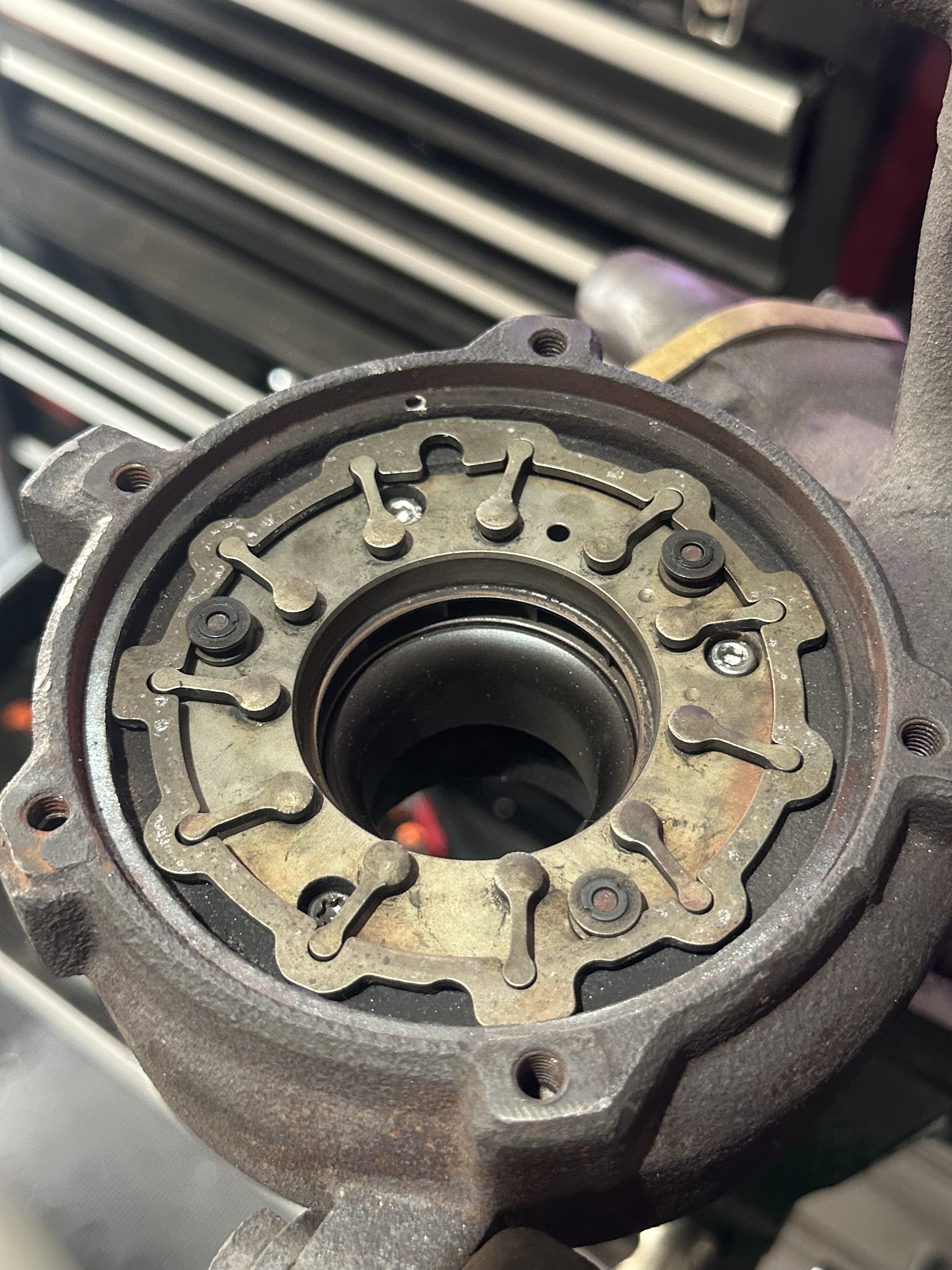

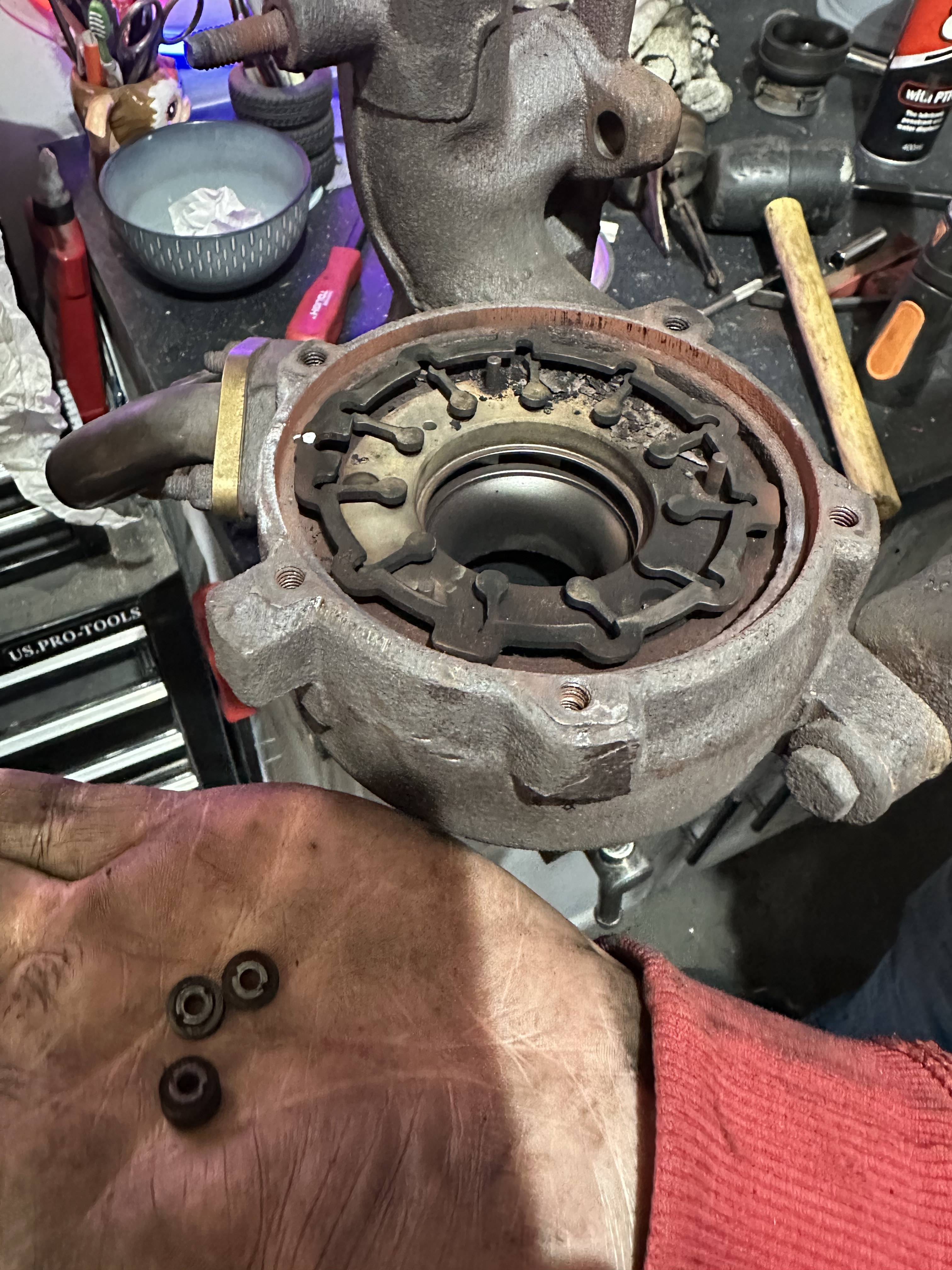

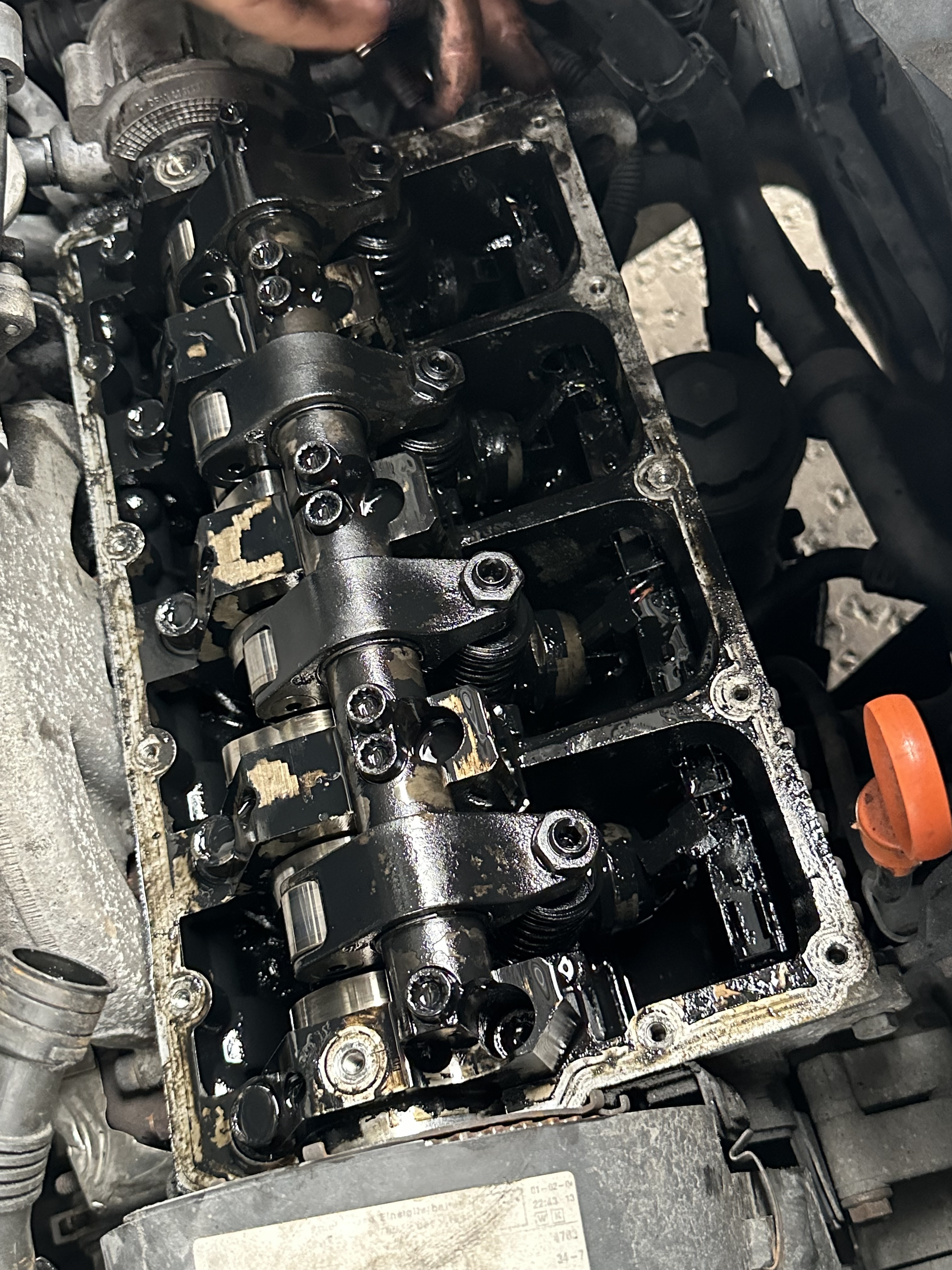

The latest episode of T5 ownership has been a bit of a nightmare… Since day one of owning the van, it’s had an issue with going into limp mode, and it’s gradually got worse and worse to the point it was becoming unusable. We scanned it multiple times and kept getting code P0234, which is a turbo overboost code usually linked to the common issue of the turbo being gunked up and the vanes not being able to function properly. So a few weeks ago, we removed the turbo and stripped it down, although it wasn’t TOO bad inside, the vanes were- as we thought- not moving. While stripping the turbo down, there are 3 bolts holding the last piece (the vanes themselves) into the hot side of the turbo, and annoyingly 2 snapped inside the housing. We then had to send it to DDC engineering who drilled the snapped bolts out and re-tapped it for us. Got it back, cleaned it all out- with recommended Mr Muscle oven cleaner- which worked a treat. Refitted it all, annoyingly snapping a T-piece connector on one of the engines vacuum lines. So waited a few days for a replacement to arrive (which was a pain to find), road tested it all today, and it’s driving well- no more limp mode! Hopefully stays this way now, because it’s a lot nicer to drive!

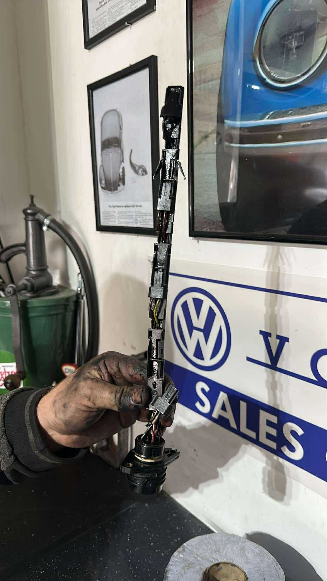

Episode 300 of Transporter engine problems… After cleaning out the turbo and having some nice driving for a brief period, the van began shuddering badly under any sort of load/acceleration. Eventually got round to investigating this weekend, with no codes showing- but when doing a live data scan WHILE it was doing the shuddering it threw up a couple of codes, a misfire in cyl 4 caused by a ‘electrical error in circuit’ which according to the PD engine gurus- is caused by a knackered injector loom- generally a bad connection somewhere. So, new one ordered- and hopefully some smooth sailing after install! :crossed_fingers:t2:
