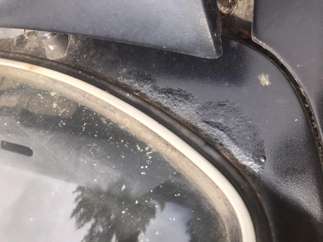

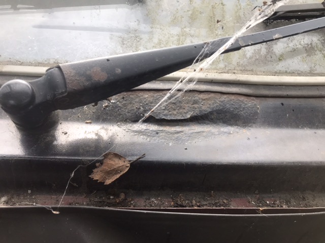

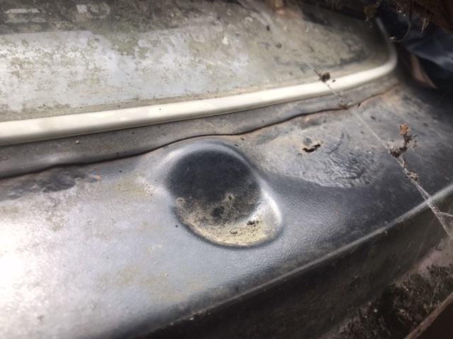

I’m going to have to repair the windscreen panel on the mk1- it’s gone under the seal basically and spread out, but the front section is still solid and original. I was thinking of taking just the back half of the repair panel and leaving the front in. Does that sound reasonable?

You wont know how bad it is until you removed the windscreen and see how far it has spread. Generally I try to only remove the metal I have to ie just beyond any thin metal.
